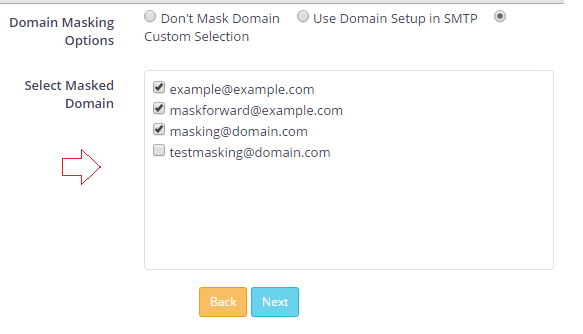

g)      Sending from Multiple Domains:
Domain selection has already been discussed before while explaining the 3rd step of the process of scheduling an email campaign. You can mask the domain of the current installation/ local domain with a masking domain setup in the selected SMTP.
Or you can also select more than one masking domain with the help of “Custom Selection” the third option to select a sending domain.  See the following Figure#4.6.1. If you select multiple sending domains, the application will follow the same pattern of rotating the selected domains in the cycle, cyclic rotation has been discussed various times.
Figure#4.6.1: Selecting more than One Sending Domains
