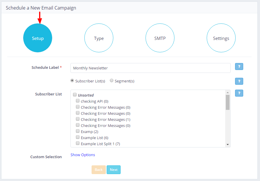

1st Step: Setting up Basic Details
Figure#4.4.1: Setup Campaign Schedule Details
a) Schedule Label
The schedule label is different from the campaign name that you have provided during the process of creating the content for the new email campaign. The email campaign name helps to identify a particular email campaign among the existing email campaigns, while the campaign schedule label is something that distinguishes the particular campaign, among the list of scheduled emails in the queue.
This name appears in the table of “View Scheduled Campaign” under the column of“Label”. And the “Campaign Name” appears on the “View all Campaigns” table to identify the campaign. So don’t get confused, fill in the field with the appropriate schedule label, and move forward.

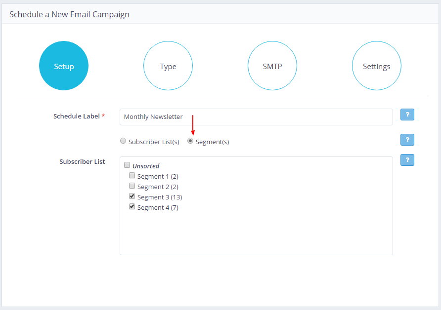

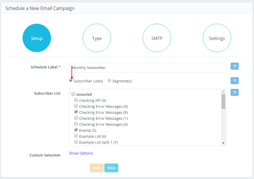

b) Select Between Subscriber List or Segment
Formerly Mumara only offered the ability to select an email list for scheduling and sending email campaigns, and the only way of sending an email campaign to segments, was to either copy/move segment to another list within the application, or export and import them to a list.
But during the recent product upgrades, "Mumara Segments" was injected with new functionality. Segmented records now can directly be saved and can be selected during the process of scheduling an email campaign. So this particular option lets you select between currently available subscriber lists and saved segments.
The following images illustrate how currently available lists appear upon selection of the "Subscriber List(s)" option and how saved segments appear if segments are selected to schedule an email campaign.
Figure#4.4.2: Selecting List(s) to Send/Schedule Campaign
 Figure#4.4.3: Selecting Segments(s) Send/Schedule Campaign

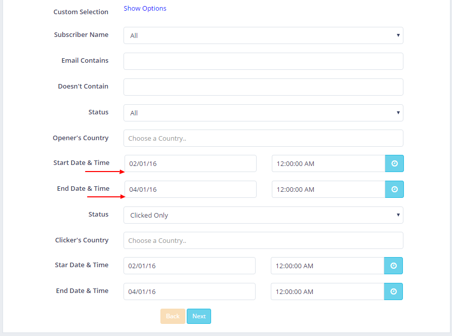

Custom Selection
Setup more custom options for the subscribers to receive the newly scheduled campaign, the custom selection allows setting up custom criteria for the specific number of subscribers in the selected list(s) to receive the email campaign. Click “Show Options” to use the options discussed below.
Note: The custom Selection option will not be available if you have selected to schedule this campaign for segment(s). Custom Selection will only be available for subscriber lists.
1) Subscriber Name
A dropdown opens up with number of options to select the subscribers from the selected list(s). Using the dropdown, you can setup this new campaign only for the subscribers saved with or without a first name, last name, or both together. Keep the dropdown at “All” if you don’t want the dropdown options to affect your selection.
2) Email Contains
Schedule this campaign only for the subscribers in the selected list whose emails contain some common attributes, like name part before @ or domain name after @. For example, schedule this email campaign only for the subscribers having Yahoo as their domain.
3) Email Doesn’t Contain
It follows the same process as described above for the email contains, with the only difference that it helps to schedule campaign only for the subscribers whose email doesn’t contain some common attribute. For example, type @yahoo.com in the field and schedule this campaign for all the subscribers other than the subscribers with Yahoo.com as their domain.
4) Status
This filter has already been elaborated in the article Mumara Segments, here are the details.
Table#4.4.1: Schedule for Opened Only, or Unopened Contacts Only
All
Schedule this email campaign for all the subscribers in the selected list(s), without being selective for opened or unopened. Keep the dropdown option at “All”
Opened Only
Opened in the selected email list(s) will only be selected to receive this email campaign.
Unopened Only
This will filter and send the email campaign to only the unopened subscribers within the selected list(s).
5) Opener's Country
The filter opens by their country
6) Filter Opens Between Specific Date&Time
Use "Start Date&Time" and "End Date&Time" fields to separate out records between specific date. The following image demonstrates that the filter is set to segment opens between 02/01/16 (12:00 AM) to 04/01/16 (12:00 AM).
Figure#4.4.4: Between Specific Dates
7) Status
All
Schedule this email campaign for all the subscribers in the selected list(s), without being selective for clicked or unclicked. Keep the dropdown option at “All”
Opened Only
Send this email campaign to the contacts that are still categorized as unclicked within the selected list(s).
Unopened Only
8) Clicker’s Country
Filter clicks by their country
9) Filter Clicks Between Specific Date&Time
Use "Start Date&Time" and "End Date&Time" fields to separate out records between specific date. Above figure#4.4.4 demonstrates that the filter is set to segment opens between 02/01/16 (12:00 AM) to 04/01/16 (12:00 AM), same is the process for clicks.

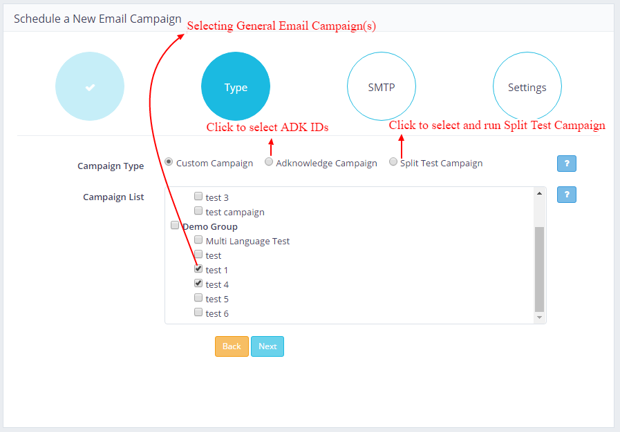

2nd Step: Selecting Campaign Type
Mumara offers a variety of campaign types to select one according to your unique requirement. All the three types are entirely different from one another, read the following passage to know more about the types, and the variation you can employ while scheduling an email campaign of each type.
Figure#4.4.5: Three Campaign Types
1) Custom Campaign
It can also be categorized as general purpose campaign, a general purpose campaign can be a “Monthly Newsletter Campaign, or can also be a promotional campaign to all existing subscribers. You’ll be provided the “Custom Campaign” option selected by default, and underneath the selection, you’ll be offered the list of email campaigns you have created earlier using the “Create an Email Campaign” page. Select the campaign by ticking the checkbox and proceed.
More than one campaign under one “Schedule Label” is also a valid selection, if the email campaigns are categorized with campaign groups, all campaigns under one group can be selected by selecting the Group Name.
Scheduling a custom campaign is a flexible process and you can apply a number of custom sending patterns. All these sending variations are discussed subsequently under the article “Sending Variations”.
2) AdKnowledge Campaigns
During the past few years, AdKnowledge has overwhelmingly performed well. Especially “AdStation” the email advertising channel of ADK has been continuously enjoying a good reputation in the email advertising space. It is important for a person, who holds a publisher account with ADK, to maneuver the ADK campaigns in a proper way to achieve favorable results, but is it too easy? Not really, without having a good sending infrastructure, you’ll not be able to send with optimum delivery rates.
Mumara is all set for the publishers who want to take full advantage of the email data they have, it does not only enable to automate the whole process of scheduling the AdKnowledge campaigns but also provides complete delivery reports and stats to analyze and improve.
Selection of “AdKnowledge” as campaign type will enable you to select one of the email campaigns, setup by AdKnowledge against your campaign ID. The rest of the process of scheduling the email campaign will remain the same.  Select the campaign ID at this step of the process.
3) Split Test Campaign
You can try different versions of your email campaign with the help of sending a split test campaign. It helps to evaluate the best subject line, days in the week, time in the day to schedule an email campaign for the best results. But before you select split test as campaign type, you need to setup some of the instances of split tests using the “Create Split Tests” page.
More on “Creating Split Tests”
If you already have created the split tests to setup a campaign for, go for “Split Test Campaign” as a type of campaign you want to schedule and select one of the split tests, from the list of existing split tests available.

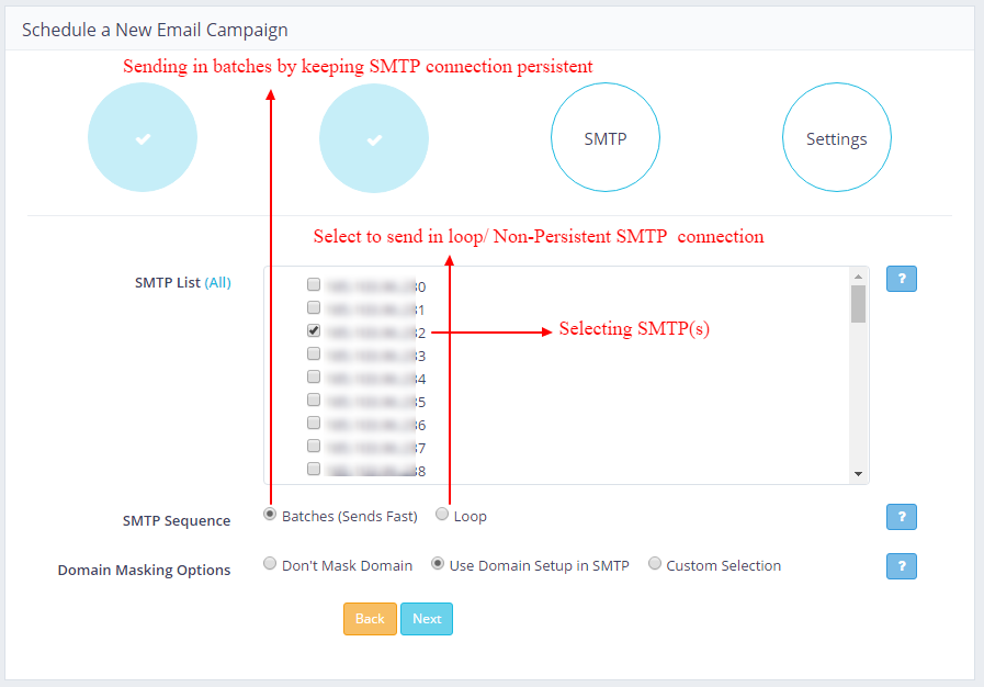

a) SMTP Selection
Select by ticking the checkboxes with the list of SMTP accounts you already have configured. Mumara offers the ability to setup your system with multiple SMTPs, and if you are using PowerMTA Server, the process is completely automated using the PowerMTA Configuration Addon of Mumara.
Select one or multiple SMTPs to rotate the SMTPs and eventually the IP(s) behind the selected SMTPs. The process of multiple selection and rotation is supported by Multi SMTP/MTA addon.
b) SMTP Sequence
How do you want to sequence selected SMTP(s)? The application offers two options. Once you select your preferred option for the SMTP sequence, the application will then behave according to your preference. The two available options are.
1) Batches-(Persistent SMTP Connection)
If selected, the application will divide the number of emails to send on the number of selected SMTPs, to create sending batches. The maximum size of a batch can be 500 emails per SMTP. Let's take a look at the following example to understand it more closely.
Note-Batch sending is convenient and fast, as once the connection with one SMTP account is established, it doesn't close until the SMTP account completes its batch size. This way, a good number of emails are sent before switching to the new SMTP account.
Example:
If the selected campaign has scheduled for 5000 subscribers, and 4 SMTPs are being selected to complete the sending process. The application automatically will conclude that the sending amount is larger than the maximum batch size an SMTP account can send, therefore, each one of the 4 SMTP accounts will start sending a maximum batch of 500 emails.
Example:
If the selected campaign has the fewer amount of subscribers, like 300, and 2 SMTPs are being given this task to complete sending process for these 300 emails. For this case, the sending amount is less than the maximum batch size, one SMTP account can send, therefore, it will divide the number of subscribers by the number on the SMTPs(300/2), and will conclude that each one of the 2 selected SMTP accounts will be sent in an equal batch size of 150 emails.
2) Loop
Select this option if you want to send it to be performed within a cyclic loop. The following example will further help to understand loop operation.
Example:
If the selected campaign has scheduled for 500 subscribers, and 5 SMTP accounts are being selected to complete the sending process. 1st email will be sent from 1st SMTP account, and to send the 2nd application will select the second SMTP account in the sequence, the process continues. The cycle repeats from the 6th subscriber, and until the campaign finishes sending to 500 contacts, it keeps the same behavior of rotating the SMTP accounts within a loop for sending.
Note:
The loop sending switches the SMTP accounts too frequently that it prolongs the sending process. But it is a helpful option in few cases, like, when you are warming up your new IPs, you may need to select this sending pattern, in order to avoid bulk sending behavior from one IP.
Figure#4.4.5: Selecting SMTP Account(s) and SMTP Sequence
The topic of selecting more than one SMTP accounts is discussed under “Sending Variation.

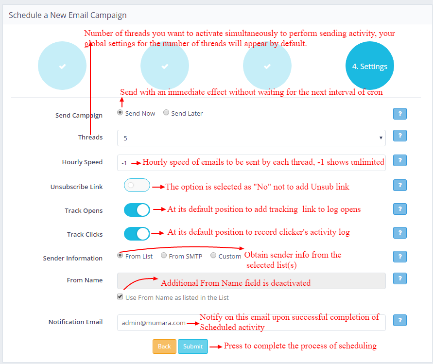

4th Step: Sending Settings and Preferences
After you have completed the first three steps, the fourth step will let you set the sending preferences. The first among the settings is “Send Campaign”. This offers you the ability to select one of the options from the following two.
1) Send Now
Selection of this option will immediately start sending the email campaign that you have just setup by completing the previous three steps. Once you setup the other related preference on this very page and click “Submit”, the sending starts right away, without having to wait for the next interval of cron.
2) Send Later
Send later is the second option next to “Send Campaign” and upon selection of this option, another option to select Date and Time will appear below. The selection of this option will enable you to schedule your email campaign to send at a later date and time.
(Sending Time)
Once you click the second option to send the campaign later at a particular date and time, the calendar for the selection of date and time will appear below. Choose the desired month, day, and year using the calendar. You can also insert the date and time manually in the respective boxes.
Note:
Enable your server for Cron support, in order to perform scheduled tasks with preset intervals of cron.
More on “Cron Settings”
a) Threads
Select the number of threads you want to use while sending of the email campaign. Make sure that you have subscribed to the multithreading module and have applied to your preferred setting for "Multithreading". You can select the same number of threads you have proposed while applying the general settings for "Multi-Threading", or you can select differently than what you have proposed in the general settings. Learn more about multithreading by clicking the link below.
More on "Multi-Threading"
Note: The option to perform parallel sending activity (Multithreading) is currently available for "General Email Campaign" and also for "AdKnowledge Campaign".
It is highly recommended practice to always add an unsubscribe link within your email body, Mumara well recognizes the importance of this unsubscribes link, to provide your subscriber with a chance to unsubscribe from the mailing list, instead of hitting your email as spam as having an only option to get rid of further emailing.
You are being given an option to add an unsubscribe link when creating the content of the email campaign using the "Custom Variable" option. Adding Unsubscribe link during the creation of the email campaign will give you the ability to adjust it anywhere in the content of your campaign.
However, this option while scheduling an email campaign would add the unsubscribe link towards to bottom of your email campaign. By default, the button appears in blue color, and keeping it at the default position will automatically add an unsubscribe link towards the bottom of your campaign.
Work this button towards the left, if you already have added an unsubscribe link and want to skip this option. Figure#4.4.7 shows that the button is set not to add unsubscribe link.
c) Track Opens
Selecting this option as yes will automatically add the tracking link (Pixel) to determine your recipient's interest and creating the logged event of opened emails. By default, it is set to track the opens of the particular email campaign that you are scheduling right now. If you don't want to track the opens, slide the button towards the left side, just as you do in case you don't want to add an "Unsubscribe Link"
d) Track Clicks
It will automatically update the hyperlinks in your email campaign to track the clicker's activity log. When the recipient clicks the link in your email campaign, it promptly stays on the tracking domain URL, before the recipient lands and views the actual destination link within the email campaign. During this precise stay, Mumara records the clicker's activity log. By default, it is set to track the clicks of the particular email campaign that you are scheduling right now. If you don't want to track the clicks, slide the button towards the left side.
e) Sender Information
Sender information is the set of information that will go along with the email campaign, which you have scheduled to send. Mumara offers more than one option to select this information before you finalize the scheduling of the email campaign. The sender information comprises of the following.

You will be able to view the following three options to obtain the sender information, right under “Unsubscribe Link” at the bottom of the fourth and final step “Settings” of the “Schedule Email Campaign” page. Here are the details of the three options.
1) From List
Selection of this option means that the system will get the sender information such as From Name (List Owner Name), From Email (List Owner Email), Reply to Email, and email address to collect Bounces, from the selected list(s). Each subscriber list across the application has this sender information batch saved, and on the selection of the option to send “From List”, the information will automatically be taken from the sender information batch saved in the subscriber list. Figure#4.4.7 shows this option selected.
Note:
In case of the selection of multiple lists, the information will be taken from the list to which the system is sending the email campaign at that particular time. Read more on “Sending Variations” to know more about the selection of multiple lists.
Additional From Name Field
An additional field will appear below once you select “From List”. The field enables you to provide separate “From Name” in the field other than the “From Name” that you already have provided during the creation of the selected list. If you use this additional from name field, this from name will replace the name setup and saved in the sender information batch of the list. The rest of the information such as “Reply Email” or Bounce Email will remain the same as saved with the list.
However, if you don’t want to use the additional from name field and want your email to be sent out using the from name setup in the sender information batch of your list, then tick the checkbox underneath the additional from name field, to make this field irrelevant. In the following Figure#4.4.7, this option is being deactivated.
2) From SMTP
The second option next to “From List” is intended to select the sender ID batch that you have created while setting up the selected SMTP account(s).  The selection of this option will enable the application to automatically get the required sender information from the select SMTP account, and send this campaign using the set of information saved in a particular SMTP account.
If you have selected to send a campaign from multiple SMTP accounts, for example, 5 SMTP accounts. And the selected list has 20,000 records (Subscribers), the system will automatically divide the number of records/subscribers (20,000) on a number of SMTP accounts (5). After the division, each batch (4,000) of subscribers will receive a campaign using a separate SMTP from the 5 available SMTP accounts. And the sender info for each batch will be taken from its respective SMTP account.
3) Custom Sender Information
If you opt to provide “Custom” sender information, the following fields will appear on your screen to provide relevant details to move forward.
Extension-Table#4.4.1: “Custom” Sender Information Details
From Name
Name of the person/company who has sent the email. The name will appear in the form field of your recipient’s email client.
From Email
Email of the person/company who has sent the email. It helps recipients to recognize the sender of the email.
Bounce Email
Email address/ account to which you want the bounced emails to be sent.
Reply To Email
It tells the recipient that in case of replying to the message. A reply will be sent to that “Reply to” email.
The selection of the “Custom” sender information ensures that no sender information has been obtained from list or SMTP, and the particular email campaign is to be sent using the custom sender details.
f) Notification Email
Put forward an email in this field to notify the sender/scheduler when the scheduled activity is successfully completed (Scheduled Campaign Sent Successfully).
Figure#4.4.7: Sending Preferences
Complete the process of Scheduling by Pressing "Submit".
