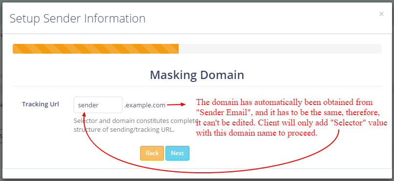

3rd Step-Setup Masking Domain
Here comes the step to settle with the sending URL, it also refers to as Masking Domain. Let’s discuss both the terms.
Sending URL/Tracking URL-
The emails will be sent from that particular URL, and the recipient of the email will be able to view this URL as a sender or mailed by domain. Later in the next step of this wizard, we'll be using this domain to mask the ESP's primary sending domain. So typically the URL will go along as a tracking URL, in the emails that a particular client will send.
The domain part of the tracking URL isn’t editable, and it has automatically been obtained from the domain mentioned with “Sender Email”, as sending email domain, the sending/tracking URL domain has to be the same for valid identity.
The empty box before the domain name is for the client to provide the selector value to be used with the domain name. Both selector and domain together constitute the complete structure of the sending URL. The selector is also known as a prefix, alias, host, or simply selector. The selector can be anything like, send, link, etc. Press next after filling the selector area.

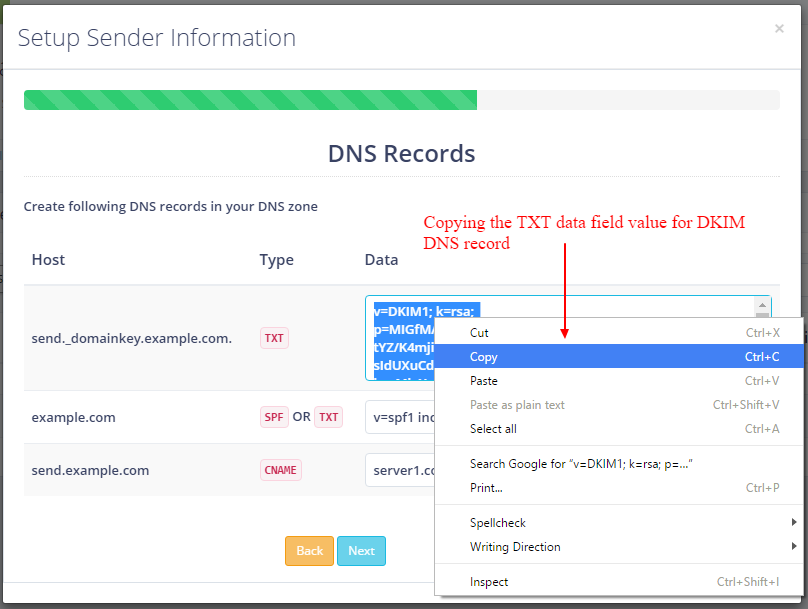

1) DKIM Record
The first entry in the process of implementing the DNS record is DKIM authentication (Domain Key Identified Mail). The entry under the host field is automatically generated with the corresponding selector/ prefix, by taking it from the sending URL you have provided in the previous step.
The selector is the attribute for the DKIM signature, used with the domain name to manage and support multiple keys for the same domain. It adds a differential attribute with each public key you generate for the same domain; however, the validation process considers the selector as an additional attribute in the signature. For most of the people, one selector is enough to pass their authentication and keep their workflow smooth, except for the organizations with administrative divisions and diverse staff roles.
They can use anything as a selector, like individual user names, department names, locations of geographically dispersed offices of an organization, or even the joining dates of the employees. But as most of the clients don't need to use multiple selectors for the DKIM record of the same domain, therefore a selector might readily be selected by taking it from the host/selector/prefix field of the sending URL.
You can provide your own preference for the selector in the small text box with sending URL field during the 3rd step of the wizard. Whatever you will put into the box, the application will take it as the selector, to create the entry for the related records.
Now as the application has returned with DKIM values and public key to be configured into the DNS, it is the right time for you to learn to put the values in the DNS of the sending domain, side by side. All you need to do is copying the values and putting them appropriately in the relevant fields of the sending domain DNS.
Access the DNS of the sending domain, The DNS interface for different control panels appear slightly different than one another, but still, you will be able to locate the elementary fields in all the control panels, including Cpanel, Plesk or CloudFlare, etc.  You may reach the required page to edit DNS settings and to configure the record by clicking “Advance DNS Zone Editor” in Cpanel, and “DNS Settings” for both Plesk and Cloudflare. However, we’ll be using Cpanel during the course of the discussion.
DNS Entry of DKIM Values
Reach the DNS of the relevant domain (In Sender Email and Sending URL), “Advance DNS Zone Editor” in case of Cpanel. Once you are in at “Advance DNS Zone Editor” you’ll find 3 text fields along with the dropdown to select the type of record you are adding. Here are the fields that you need to fill in order to add a new record. The table followed by the figure below discusses the information which you need to add in the respective fields to add a public key appropriately into the DNS of Cpanel.
Figure#19.2.7: DNS Entry of DKIM Record
Table#19.2.3: Adding a TXT Record (DKIM)
Name
The source field needs to be filled with the domain name, if you write down only the selector, the field automatically detects the domain to complete the entry.
Mumara comes up with a complete DNS entry under “Host” during the step "DNS Records" of the wizard. Where you need to just copy the value from the relevant “Host” field in the wizard, and paste it into the “Name” field of the DNS.
It is recommended to copy the value created by the application according to your sending domain, instead of doing it manually.
Figure#19.2.8 demonstrates the copying of the host field
TTL
It refers to the Time to Live for the DNS entry, and the field needs to be filled with a positive integer, which indicates that how long the DNS entry should be cached by the client( In seconds).  The default TTL varies from DNS to DNS, however in Cpanel the default TTL is 14400 (In second)
Type
Select TXT from the dropdown as the type of record you are about to add. A domain may have more than a few TXT records which include DKIM or SPF etc. The TXT records are usually used to carry human readable information about the network or server etc.  Choose TXT and move to the next field.
TXT Data
The final field needs to be filled with the public key generated by the application. Copy the public key from the application and paste it into the related TXT data field. See Figure#19.2.9: Copying the Key followed by Copying the Host Value.
Figure#19.2.8:Copying Host Field Value
Figure#19.2.9:Copying the Key
Once you are completed, click “Add Record” (Domain DNS )to save and update DNS settings with a new record. The client just needs to configure the public key into the DNS; if the ESP’s PowerMTA server configured appropriately with Mumara, it automatically generates the private key for this public key to complete the pair and pass the authentication.

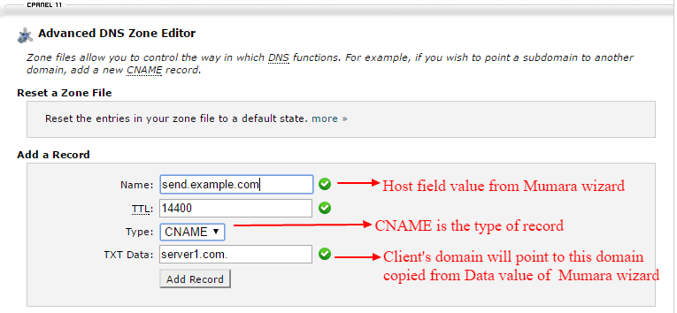

3) CNAME Record
After completing both the TXT records, now it is time for the client to setup another type of record in the DNS called CNAME.  All these records including DKIM, SPF, and CNAME are important for the clients to validate his/her identity as a legitimate sender. Therefore setup accordingly, as the white label senders won’t be able to get their accounts approved from the ESP's support staff user, until they have implemented all these records appropriately.
DNS Entry of CNAME values
You are required to manage the things from the DNS, and the interface of the DNS may vary depending on your control panel (Cpanel, Plesk or CloudFlare, etc). As we have been discussing the implementation of the records in our test case that is setup with the Cpanel, therefore here we are in “Advance DNS Zone Editor”. You can create CNAME using administrative tools provided by the domain host, depending on your accessibility and convenience. The fields to add CNAME record in the DNS are discussed in the table after the figure below.
Figure#19.2.12: Adding CNAME Record
Table#19.2.5: Adding a CNAME Record
Name
The “Sending URL” and the selector text in the small text box before the sending URL during the Masking Domain step of the wizard, create the value under the “Host” field of the wizard for CNAME. The field of the Name, Host, or Alias in the DNS needs to be filled with the sending URL. The simple way of doing it is to copy the value from the wizard and paste it into the relevant field of the DNS. The following Figure#9.8.13 shows how you will copy the value from the wizard to fill into the relevant DNS field.
The field in the DNS may auto detect the domain even by providing just the selector. However, it is still advised to copy the value from the wizard and paste it in the field, to avoid confusion and possible error.
TTL
It refers to the Time to Live for the DNS entry, and the field needs to be filled with a positive integer, which indicates that how long the DNS entry should be cached by the client( In seconds).  The default TTL varies from DNS to DNS, however in Cpanel the default TTL is 14400 (In second).
Type
Select CNAME from the dropdown as the type of record you are about to add. As mentioned earlier, the CNAME record is used to map a name with another name. Select CNAME and move to the last field to complete the record entry.
CNAME
The domain with the corresponding selector in the above field of "Name", will point to the domain you will enter in this field. The Sender Information Wizard recommends the complete URL to copy and put it into the field of CNAME. It would be the ESP domain suggested during the configuration of "Sending Server". Your Sending/Tracking URL will actually point to this domain.
However, as everything has been precisely setup until now, to keep it smooth, just simply copy the record from the wizard and paste it in the relevant field of the DNS (CNAME in case of Cpanel).
 See Figure#19.2.14: Copying Domain/Value for the CNAME

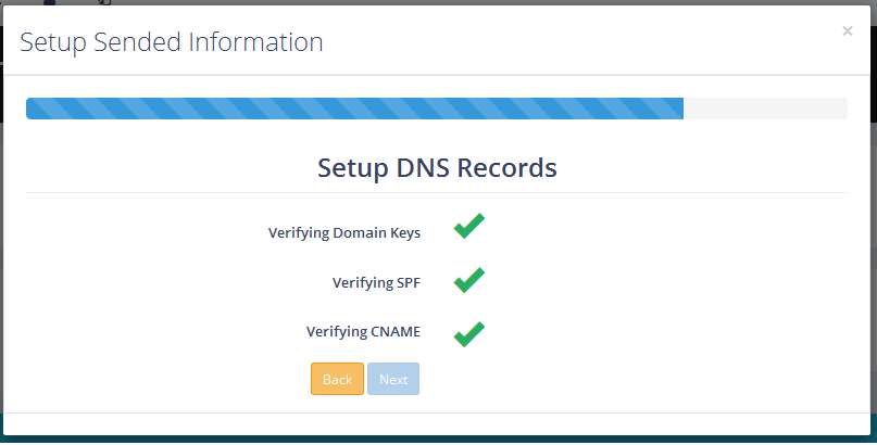

5th Step: Verifying the DNS Entries
After completing the required DNS entries with the corresponding DKIM public key, CNAME for masking domain, and SPF to authorize the sending server to send on behalf of your domain, click “Next” to start verifying the process of the DNS entries. The process of verifying the DNS entries starts as soon as you click “Next”, Figure#19.2.15 shows how it looks when the application is in process of verifying the DNS entries.
Figure#19.2.15: Verifying DNS Entries
If the application verifies all the entries successfully, the application will put the following screen on display.
Figure#19.2.16: DNS Entries are Successfully Verified
