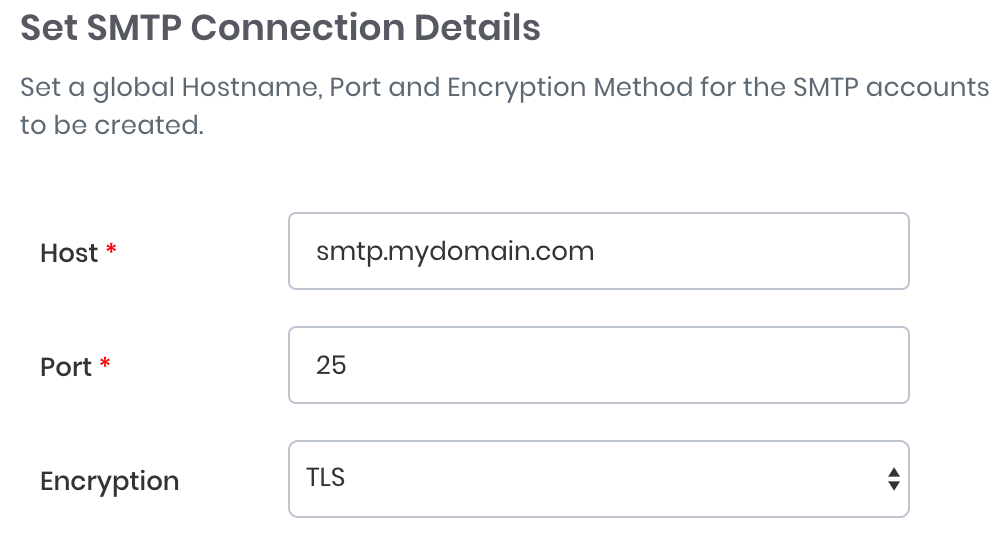

 Step 3: SMTP Settings
Configure the SMTP settings that your Nodes will be connected with.
Form Fields
FieldDescription
SMTP HostThe hostname of the SMTP(s) that are being added as Sending Nodes.
SMTP PortPort number of the SMTP connection that you want to be.
Mail EncryptionSet it to None if you don't want PowerMTA to encrypt your outgoing emails.

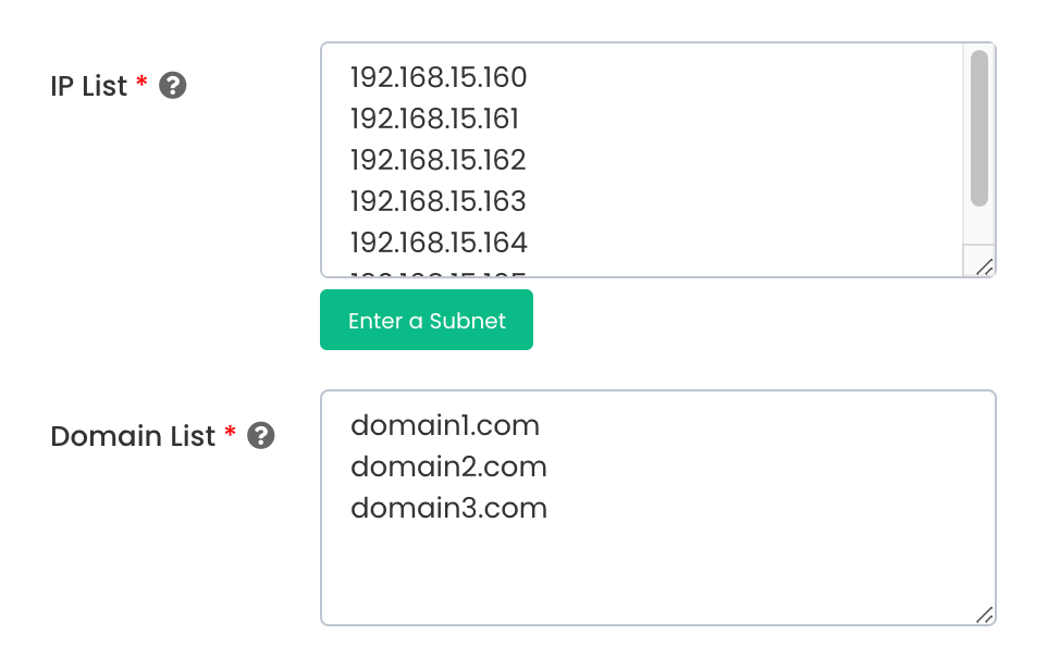

Step 5: IPs and Domains
Define the IP addresses and the sending domains that will be used for the email sending purposes. Mumara will generate the best combination of IP addresses over the domains on the next page that you'll have the ability to rearrange according to your requirement (if any).
FieldDescription
IP AddressesThe IP addresses added in your server that you want to get involved in email sending purposes.
Insert a SubnetIf you have a full subnet, add it in an easy way.
Sending DomainsThe domains that will be responsible to relay emails.

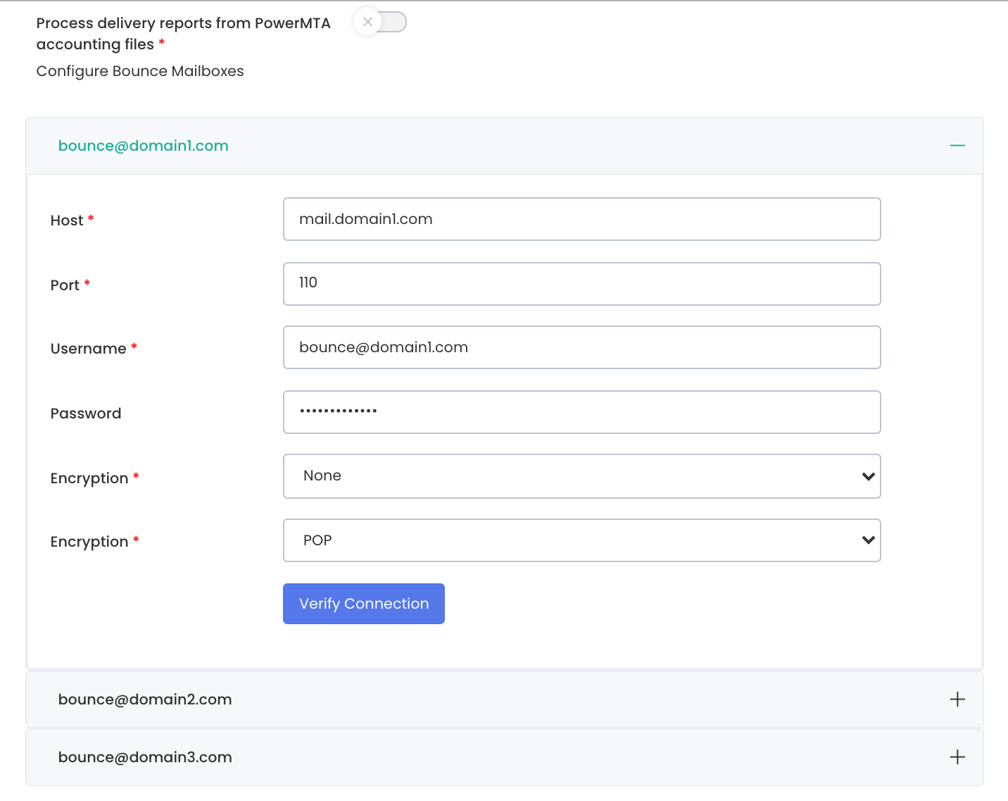

Step 7: Configure Bounce Mailboxes
Configure the methodology of processing the failed deliveries. Mumara can two supported methods of processing the bounce reports for the PowerMTA addon
  1. Process bounces from bounce mailboxes using POP/IMAP method
  2. Process bounces from PowerMTA accounting files (Recommended)
1- Using POP/IMAP Connection
Fields:
FieldDescription
HostHostname of the mail server where this email address is hosted
PortPort number of the mail server to make POP/IMAP connection
UsernameUsername of the mailbox
PasswordPassword of the mailbox
EncryptionChoose the encryption method if your mailserver needs the connection to be encrypted
MethodSelect from POP/IMAP (as advised by the mailbox provider)
Verify ConnectionIt verifies the connection with your mail server before processing ahead
Turn the switch to disabled and Mumara will ask you to configure and connect with the bounce mailboxes responsible to receive delivery reports for the failed messages. If this process is selected, Mumara will perform the following tasks

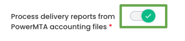

2- Using PowerMTA Accounting Files
If the switch is set to enabled, Mumara will not process the POP/IMAP method. Mumara will now look for the PowerMTA accounting files and do the following tasks
Note: In this case, Mumara processes delivery status for every record (not just failed messages)
PowerMTA Web Monitor URL should be accessible by the Mumara server. So you need to make sure that the Mumara server IP is added PowerMTA config file with admin access. However, when setting up via Mumara, this IP is automatically added.

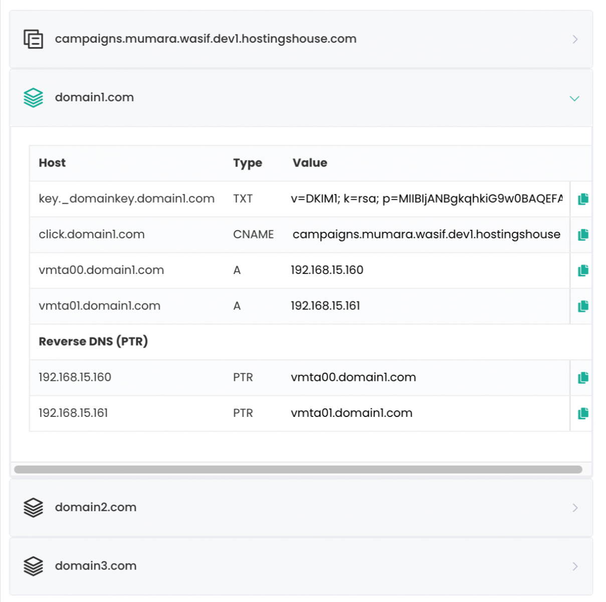

Step 8: Authenticate Sending/Tracking Domains
Mumara generates Forward DNS, Reverse DNS, CNAME, and Domain Keys to get your sending domains authenticated. Expand the toggle(s) to get the values of the DNS entries for the sending domains. Moreover, you can click on the Download button and update them later.
Fields:
FieldDescription
HostThis field contains the host key that is a prefix of your domain name. Make sure just to copy the host value (neglecting the main domain) to your domain's DNS panel as that is not necessary
TypeThis is the type of DNS field e.g. A record, TXT, CNAME, etc
ValueWhile creating the host entry, paste the value of it

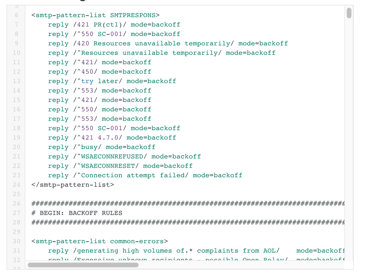

Step 9: Review of PowerMTA Configuration
It shows the configuration file that has been generated as per your inputs. If you want to tweak anything in the configuration file, you can do it in this step but make sure that you really know what you are doing.
Mumara Generated Config file is a highly optimized configuration of PowerMTA. Making any changes to it isn't suggested but you can still tweak it according to you once it has been set.
