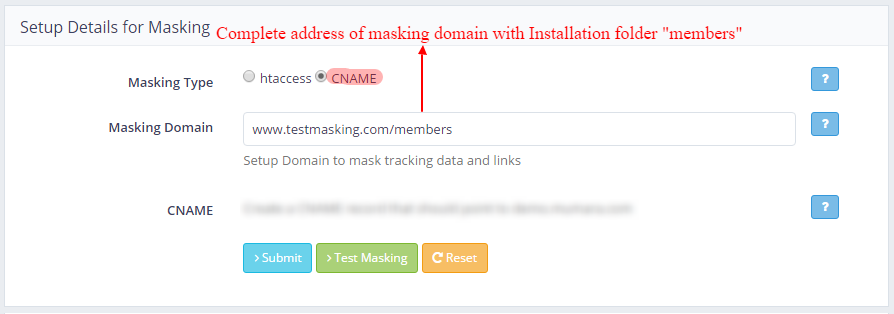

For example, the application is installed using the main domain called www.testprimary.com, and you want some particular domain like www.testmasking.com  to alias the main domain. You need to provide the complete qualified address in the field of “Masking Domain” to proceed.
Make it sure that you have provided the complete path including the installation directory to work this configuration properly. An example of this is when you have installed the application by creating a new directory like www.testprimary.com/memebers, the masking domain URL must end with its path including the installation directory “members” in the end (www.testmasking.com/members).
Keep reading the relevant information followed by Figure#7.1.3 for further understanding.
Figure#7.1.3: Masking Domain using CNAME
